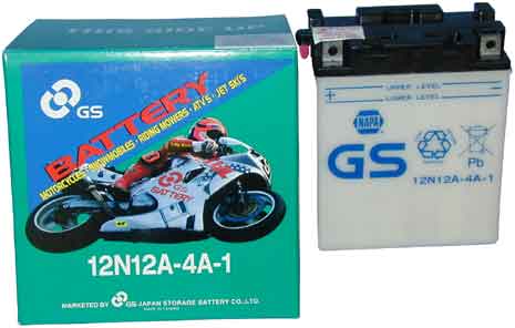

Anyhow, feel like I scored some good deals on Ebay. Here's some pictures of the parts. I'm certain they will not look nearly as good on arrival.
Parts bought and ordered:
Original Bike
Rear signal lights
Seat cover
Tach cable
Throttle cable
Complete front tire and rim with hub/braking
Complete rear rim with hub/braking
Rear shocks
Engine chain cover
kick stand
battery
Forks
Engine (5 bucks+95 shipping)
Right side A/F cover and tag
Total cost = About 483 bucks
