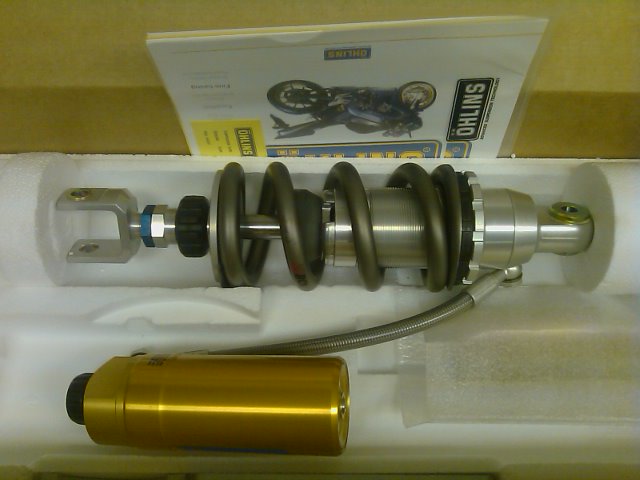

im with ya on it. i understand the mods wont convert my 919 into a 600ss, but i just installed my rear ohlins and my new springs/oil up front, and hopefully ill see some overall improvement in the way it rides/handles.

You'll love what the Ohlins does for the rear. It kept me from selling my 919.

i agree, the rear end is horrible, but i dont have $900 for a single shock. nor do i want a shock that is specificantly fine tuned just for me. i do alot of 2up and i carry my gear when i go on long commutes, so i need some adjustability if that makes sense.
Riding around with a high performance rear shock that is tuned to you will still provide better overall ride quality when riding 2-up than a stock shock will. You simply dial the preload up to max & make due when you have a passenger, but what you will find is that the linear spring and the better damping alleviate alot of the wallowing around that you normally get with a pillion rider.
Additionally since the 919 lacks any type of linkage on the swingarm the shock has to run a very high spring rate. Unlike lower spring rates where the springs are available in half rates 80, 85, 90, 95Nm etc anything over 120nm pretty much only comes in full rates 120 , 130, 140 & so on. The standard spring for the Ohlins shock is 180nm and that means that it can basically handle a much broader range of rider weight and in doing so loses some of the fine tuning ability that a bike with a linkage requiring lower rate springs would have. The good news is though that it is still much more closely tuned to what the 919 needs than the stock shock could ever dream of being.
Old 03-04-2010, 11:51 AM   #35
Location: Portland, Oregon
Posts: 472
sigh.... ur not helping LDH.... lol!
i STILL cant afford $900, nor can i justify paying 1/3 of the total motorcycle price on just 1 damn shock... what's this revalving and new spring talk relating to the 919 shock? is this a viable alternative?
Old 03-04-2010, 12:18 PM   #36
The Real Squidshady
Lord Duckhunter's Avatar
Posts: 1,123
A lot of people do the revalve thing on the stock shocks, but as a test rider that has sampled every level of suspension from bone stock to unobtanium Factory Superbike stuff I cannot in good conscience condone that course of action. There's just no return on the investment. Might as well be lighting that money on fire. Stock shocks are crap period, they aren't worth their weight as a boat anchor and I feel anyone that offers to revalve it is just trying to get money out of the customer with little regard for what they are giving them in return kinda like a used car salesmen. I mean we won't even touch a stock shock here...
Furthermore if you are serious enough about wanting to improve the ride quality of the bike to want to spend $200-$300 on a revalve of the stock shock that doesn't do much of anything then why not save up the money get the $900 and have the best product available in the world. That will not only increase the actual performance & value of the bike, but also your mental confidence as well which is sometimes even more important...
Old 03-04-2010, 02:53 PM   #37
Posts: 397
Just how transferrable are the Ohlins? If I buy one for the 919, would I be able to transfer it to a future bike, or sell it to someone who owns something other than a 919? Just asking, since I don't expect $900 to drop in my pocket anytime soon.
Old 03-04-2010, 02:57 PM   #38
The Real Squidshady
Posts: 1,123
It's made specifically for the 919. It might fit physically fit another model of Honda etc, but the valving and selected spring rate/size is for the 919 and would not be optimal on any other bike.
Then again I've got a Hornet 600 shock that is about to be fitted to a VTR250 and regardless of valving specs, with the proper spring rate I suspect it will be way better than the OEM shock. I mean it would be hard pressed to be worse LOL
Old 03-04-2010, 02:58 PM   #39
Posts: 598
ok, take away external reservoir/bladder from both (yes, Ohlins is much more superiour here) and forget about bling-bling $300 external preload adjuster (I don't mind taking the time getting my ass off the bike and performing preload adjustment with the wrench). Also take away Ohlins spring (yes it is much more stable than stock and not progressively wound for "do it all for everyone" factor as stock one.
Now please explain me what is the difference between stock and Ohlins.
So far this is what I can see:
1. Ohlins is more adjustable unit out of box. Stock unit has to be build just right and will lack wide adjustability for different riding conditions (very important for the track). Ohlins has high selection of shaft jets and needles, stock has just one selection - stock. I bet HO201 comes from Ohlins with the same jet/needle set for everyone + 2 sets of springs with different rate, one spring gets returned back.
Ohlins (that part with the spring is the seal head assembly, not found in showa):
Stock showa:
Ohlins:
Old 03-04-2010, 03:13 PM   #40
Posts: 598
Yes, Ohlins is a much much much better shock, but stock unit can be rebuild for 919 needs. My unit is being rebuild with an addition of Ohlins spring and KYB remote reservoir with 20 click compression and good amount of oil. Like you said above, it would be hard pressed to be worse than stock 04+ 919 unit.
